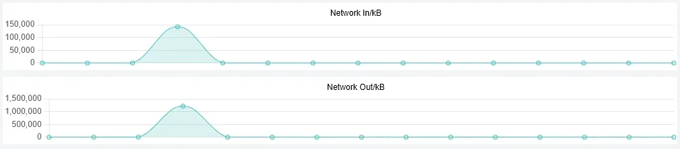

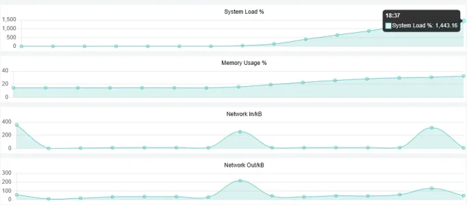

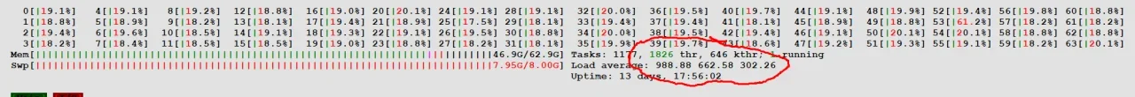

And a couple of shots of how bad this was. After I killed nginx and load started dropping I grabbed a screen shot. And I also have a shot from the ISPConfig monitor that shows data transfers. That is a 5 minute window. That big jump makes normal traffic look like 0.
