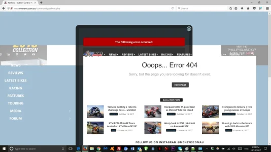

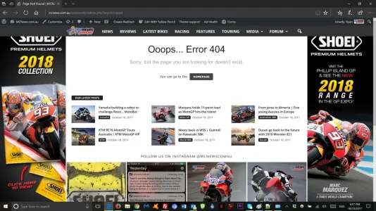

I managed to get the users imported with allot of messing around, back and forth etc. I also managed to process some of the other migration steps but on some of them it promtps me to login again, then when I login I get the below 404s.
What do you suggest? How would I create a whitelist for Xenforo import

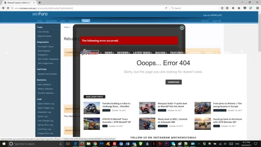

Rebuilding caches gives me this as do most other internal links. If I login and login (I I can get back in) I can sort it until I run another Import then it asked for a login, then gives me a 404 and we are back in the loop again! lol
When you say "add-on", if you mean within XF, it's unlikely to be that. The 404 appears to be coming from a page outside of XF, which emphasizes that this isn't XF related.
You may need to look into your web server config and possibly raw web server error logs to see if you can identify what is being triggered.
