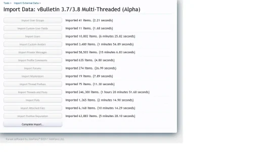

Imported 242,362 items. (13 hours 58 minutes 53.09 seconds)
Using the new and improved CLI importer:
Start: 19:10:58 Approximately 246,300 threads remaining to import.
Stop: 21:21:30
Using 4 cores, 8 PHP processes, each process was using around 32% of the core.
Total time: 2hrs, 11mins or so
Notice that the number of threads had also increased by approximately 4,000. After the thread/post import I carried on with the import but DID NOT click the "Complete import" button. So next up, let's check my new XF site. Viewing the homepage I could see that everything was where it should be but the layout required changing to ensure that I achieved a better look under XenForo. So onto the next set of tasks, the tidy up. Btw, instead of taking around 14 hours to get to this point (based on several test imports) I was here in under 3 hours.

- Login to XF admincp and then start off the import process. Things run extremely smoothly up until we come to the Post/Thread Import. Here comes the fun part, boards with millions of posts, threads etc (and private messages) take a massive amount of time. In my previous test imports this step alone was taking around 13 hours!
Using the stock importer:
Stop: 21:21:30
