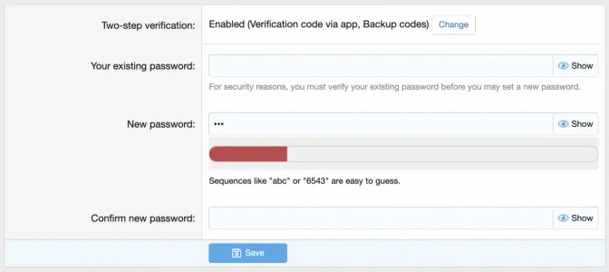

Look at the <meter> element that XenForo uses for things like password strength:

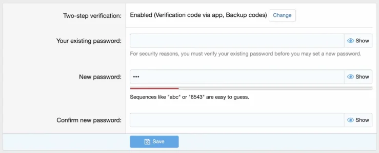

See the background color bleeding out of the meter? Make the <meter> element bigger to see it larger:
I assume the intent is for the background color to be applied to the meter itself, not the bounding box of the meter. If that's the case,

template.Look at the <meter> element that XenForo uses for things like password strength:
background-color
isn't what you use, it's currently done with browser-specific prefixes/pseudo-elements like so:
