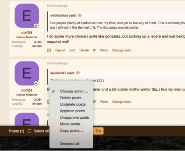

It just happened again. I took a screen shot this time. 2 posts are selected, but only shows 1 post selected. Will open a ticket with more info.

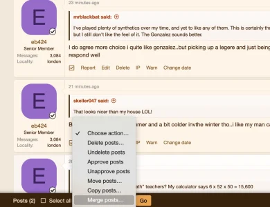

Looks like this bug is back:
I've merged a couple of hundred posts* over the past couple of days, no issue in doing so. (latest xf, php 8.0.29, nginx)
(*people refusing to using multi-quote)

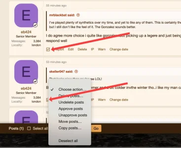

But here you choice only one post.
No I actually had three posts ticked for moderation. You are correct that's what it says, but as you can see at least two were chosen. In the second post the box is also ticked but as you can it is partially hidden by the selection options.
So they are both selected but xenforo only thinks one is. Strange,

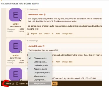

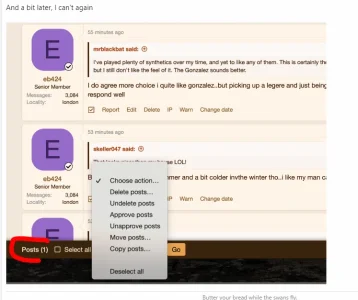

But having disabled all addons and still have the issue (most of the time) I managed to pinpoint what I think is the reason.
It seems to be because of a paypal donate button.
If I remove the button it seems to correctly show more than 1 post selected.
With the button in place then we get the intermittent issue. It is odd because this has only just started happening but maybe a change at Paypal has brought it on.
So what is happening exactly:
  • You can select two or more posts
  • The selected post counter only shows one as selected
  • The merge posts and merge threads options do not appear (as if only one post was selected)
  • Other moderator actions appear, and they take effect e.g. if two posts are selected and you choose DELETE, both posts get deleted although the counter is still only showing one.
