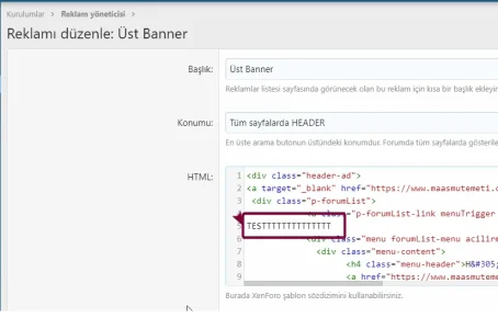

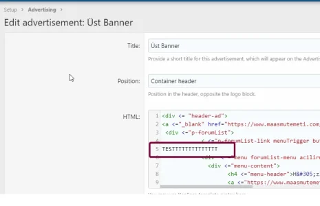

I'm fixing a code in the part of the ads. It doesn't update when I save. However, when I merge the template named _ads, it gets updated. I started having this problem after 2.2.11.
Example: I wrote this on ads i recorded
Home Page Renewed
Nothing changed.

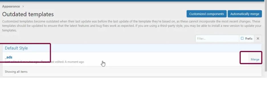

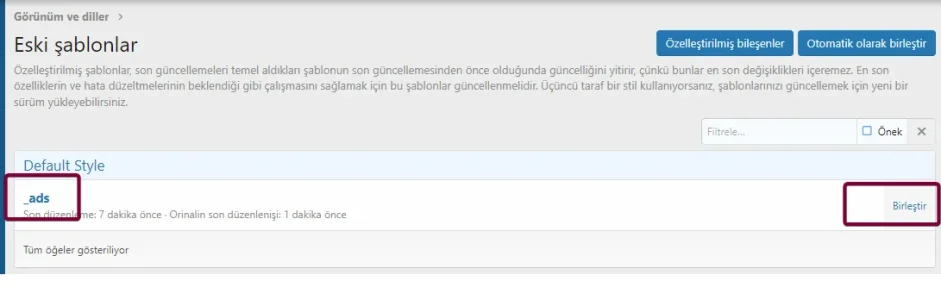

Then I came to the old templates
I said merge.

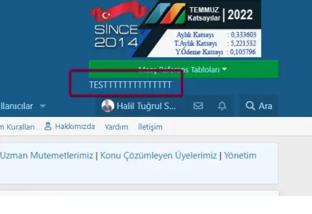

I refreshed the main page
and the update in the code is out.

When I say merge old template, the ad appears. Boredom I have to merge old template on every update

If you edit the _ads template, then it won't automatically update when you update the actual ads in the admin panel. It'll just keep showing outdated. You need to go into the _ads template and revert it (save any edits you might have in there). Future edits should always be done in the Setup -> Ads area, not the template.
Revert the _ads template to the default.
Then resave your ads.
The _ads template should never be manually edited - it is populated automatically.
You are amazing. Problem solved
