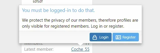

This is nice! Latest Member entry in Forum Statistics box remains linked.

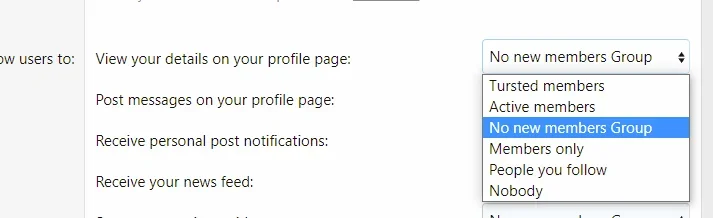

What happens to the privacy settings?
Thats a good point - for me personally it will be OK when there comes a visibil hint for members that the admin has taken some settings that can blocking this.
But yeah - the better way will be to switch the visibel settings to the real working ones.
This bug is fixed in the upcoming version. Sorry

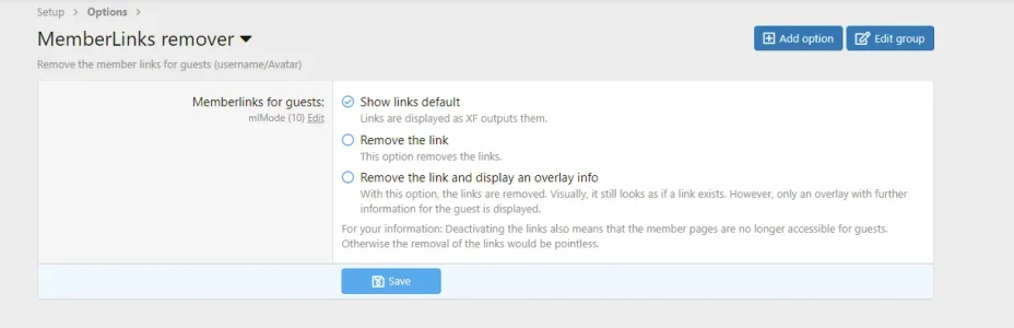

A new wish:
Please add a description phrase to/after each setting - so you can inform the admin how they can find the text from the Overlay eg. But its a luxus problem. ;-)

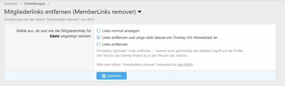

(DE translation can be downloaded at german xendach Forum)

A new wish:
Better?
