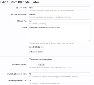

I currently have a bbcode [tex] that connect to a cgi script that produces png images for the formula. How can I modify this [tex] bbcode to use the new MathJax script.

You would have to edit the replacement for the BB code to include those $$ or \[ delimiters. If it's a media site then the replacement can be edited in your:
Admin CP -> Home -> BB Code Media Sites

It works !!!

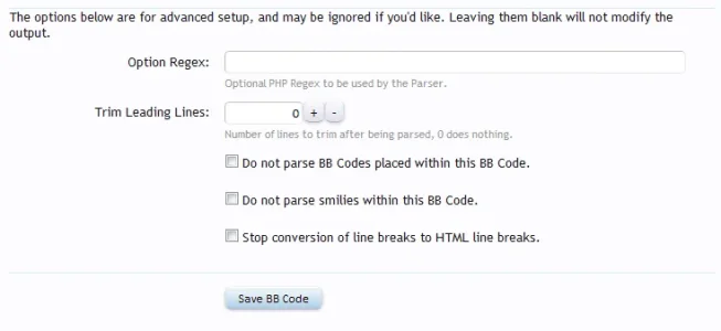

I use \[ and \] and begin and end replacement.
