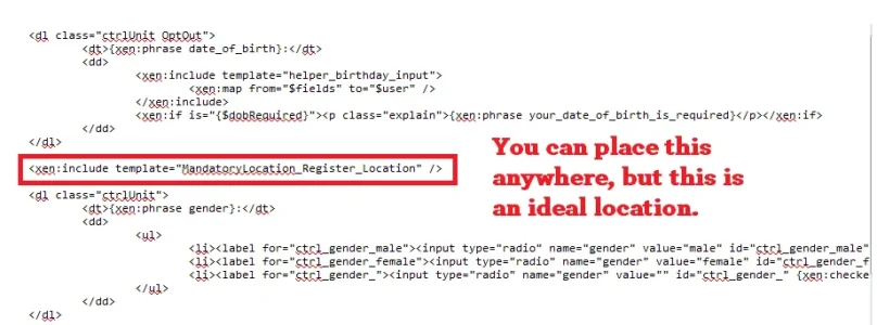

3. Do only one of the following:
3a. Add the following code to the template "register_form":
<xen:include template="MandatoryLocation_Register_Location" />
3b. Enable the experimental automatic template edit in admin options -> Mandatory Location
