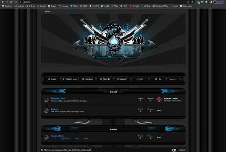

Hi, i was hoping someone maybe able to help me to make my logo wider so it touches the dark edge as per the attachment.
I am running Xenforo 2.2.10 and using a fully and completed re-designed theme that i fully own, so if it possible to make the logo wider then please help me with this issue.
Thank you in advance.
UGTeam

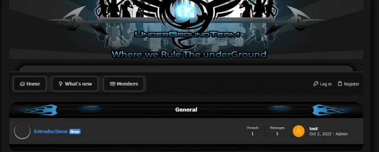

ok i have added my site link above. What i am trying to do is with my logo at the bottom there is a rounded of area where i would like to place my navbar, but i think the issue is because the navbar has links inside when i try your code all the links move down away from the navbar but the logo doesn't go lower towards the navbar. I wanted the navbar to touch the logo and make look as one.

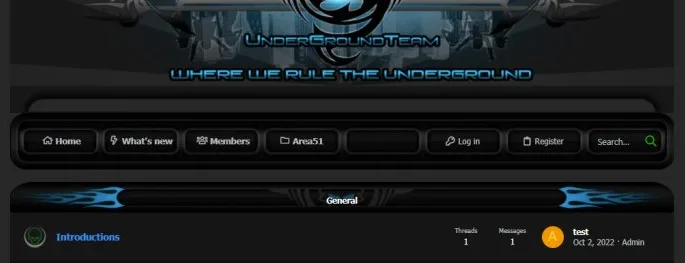

Not sure what the issue is but what I see and what you screen shot above are very different looking. If I gave you changes for one they would not work well with the other. This is what I currently see...
which is quite different than what you posted...
i am slowly getting the site ready, can you see the gap from the logo to navbar the grey area, that'sthe area i want the navbar to fit in, or lower the logo so it fits with the navbar.
I don't know if the logo can fit behind the navbar.

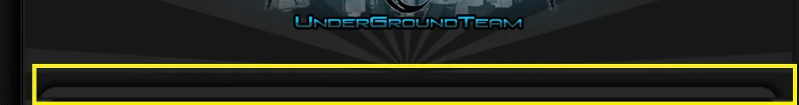

Are you talking about this rounded area?
If so, that is part of your logo...

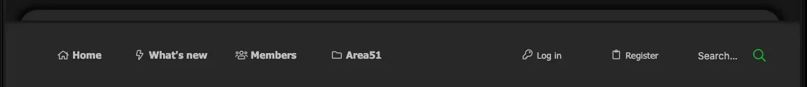

Your navigation area is using an image for the background
p-nav {
    background: url(https://ug.team/logo/navbarbgnew.png) no-repeat !important;
When you do away with it, your navbar then looks like this
Any tweaking of the text you are also going to have to figure out how to move the image background to center it.. not only for the .p-nav but the .p-nav-inner and the .p-nav-opposite.
The logo is in it's own little "box" (.p-header) and the Nav-bar has it's own little area. I don't think you can extend the logo downward easily because your navigation area is coded to use, as I said, an image and then a solid background color (background: #272727;) to blend with the rest of the page.

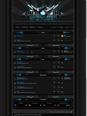

This style i designed 18 years ago with a guy called scorpion and we ran it on vBulletin 3.8.6, now i wanted to have this style running on xenforo 2.2.10 patch 1, so i re-designed all the tcats to suite xenforo, but my issue is the logo and the navbar. I wanted to look like the attachment 1 and this is how it looked in vBulletin 3.8.6.
I have made areas brighter and now it so it looks like it all matches up.
Thank you all for helping me with this issue and i am happy with the result.
