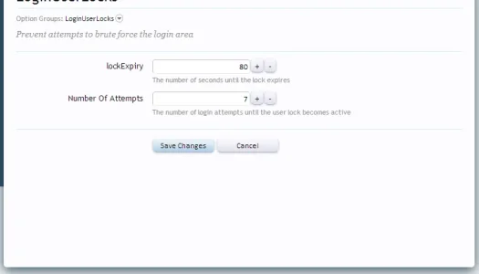

So the only area for me to do anything is in the acp/option area? There are only two values I can change, correct? Are the default settings okay?
Yay, that's good news.
Just for the future, almost all plugins have the structure
yourforum/library/X/addon-X.xml
Where X is the add-on name (but you can add the XML just about anywhere, as long as you point to the correct path when installing)
It's been a while since I looked at this (once installed, you don't need to worry about it ever again)
But it's a simple add on to prevent brute force attempts from the forum login area, the default values are reasonable, this is what I use:
And they are the only things that you need to change (if you want to), but yes the default values are good to use
You can then test it if you want, by trying to log in that many times within the time set
(in my example, I would need to try to do this 8 times within 80 seconds before I see the message)

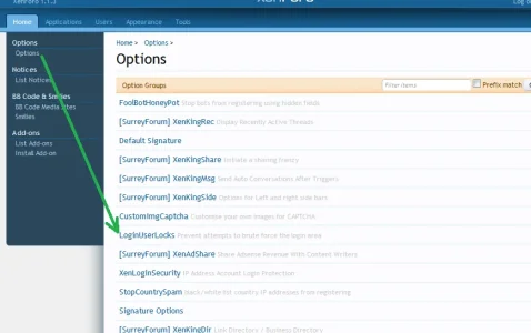

Okay, this is really embarrassing! With the ordeal of the infamous other thread and the rebuild of the backup, I lost this entire install and the work you did (setting manual approval to 'reject'). I retraced the steps and uploaded the add-on again and it worked fine. It's there in the add-on list, activated and all. But when I go to 'tools' it's nowhere to be found. Why could this be?
ACP >> Tools is usually where you find Logs and systems tools (rebuilding caches / cron jobs / system health check)
There is nothing in tools for this plugin. It's a simple plugin for user locks (it solves a security issue, and I've kept it simple)
But there are some options (just a couple) as shown in the image above.
The options for this plugin are found in the ACP >> Home >> Options >> LoginUserLocks
