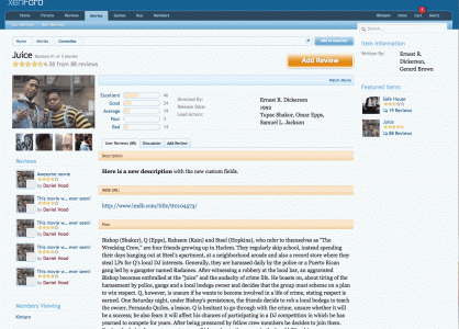

Hi,
I, @Kintaro and @Jeff Berry are having a auto close problem when trying to open lightbox. GIF is from the XenReviews but myself and Jeff had confirmed having same problem for an add-on in RM too.

The images disappearing like that happens because they failed to load -- as in, the JS received an error event. Once there are no images to display, the lightbox closes.
The demo you've shown is because viewing the full size images is actually broken there: https://xenreviews.com/attachments/images-jpg.600/ Shows a DB error (I don't know why debug mode is enabled).
The example you give here is likely being blocked because of your ad blocker being overzealous (based on the name of the resource).

Thanks for taking time to explain Mike! (y)
