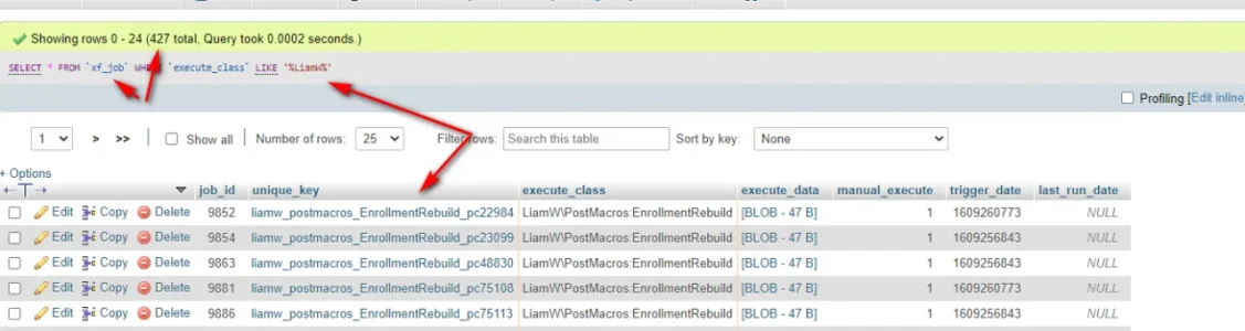

Hello,
You mean there is no block to rebluid the inscriptions of the macro gobal post?
like this : http://prntscr.com/w7v3cz
Edit :
It executes a reconstruction during the permission of the global post macro.
This means, when creating a gobal macro post, when changing permission etc... he will have a reconstruction of the post-macro gobal.
Regards, CRUEL-MODZ

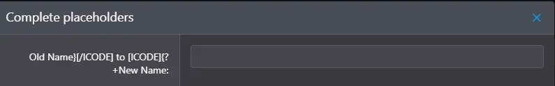

2. I also have a different issue that worked with Liam's version on XF 2.1. I just upgraded to your version after upgrading to XF 2.2
My macro:
Changed Name from [ICODE]{?+Old Name}[/ICODE] to [ICODE]{?+New Name}[/ICODE].
This has worked with Liam's version. With yours the modal looks like this:
My macro:
indeed, this will be fixed in the next update.
