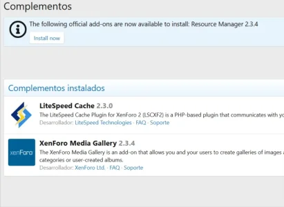

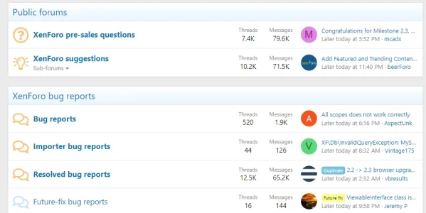

I have deleted all unused complements, and I still can't see the dates. I have Xenforo 2.3.4 and php 8.3.3
In every case I've seen, this problem has been due to Rocket Loader, outdated or improperly merged templates, or an add-on. It is unrelated to the other bug report linked.
