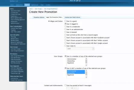

Thank you all, I can now say I understand how permissions work.
I have set most of the permissions of the registered usergroup to the "Not set" and configured the secondary groups as I wanted.
Is there a way to have as default a secondary group too ? I haven't found any option of it so I'm looking in "User group promotions" and wondering if this is consider ok or is just a bad idea.
so everybody except mods/admin are in the secondary usergroup, and I will add another promotion when someone reaches 10 messages he will be promoted to the other usergroup
If you want someone to be in a secondary group to add permissions, you should have those permissions in the primary, however, if you do an immediate promotion, that shouldn't be an issue (besides possibly not a direct promotion upon registration)
