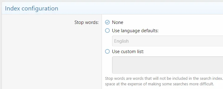

What are you searching for?
Do you have any stop words set?
No stop words set.
I searched for "oil" (it's an auto forum) and "t3g" which is the acronym for the site.
