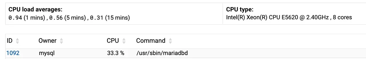

Issues with high load
Going to need to expand on that...
1) Is the XF installation the only site using MariaDB on the server?
2) How many concurrent users are you showing on the site when your are seeing this load (30%+)?
It does seem high. Have you tried restarting the Database Server? Something could be hanging causing a load increase.
Another thing to check is 3rd party add-ons, if you have a bad query or two in a poorly written add-on you can see loads jump quickly especially on a busy site. You can try disabling all add-ons, or add-ons one-by-one to find the possible issue.
With the decimal based load numbers like 0.94 that's not 94% load like you'd expect.
1 CPU core system: 1.0 = 100% load
8 CPU core system: 8.0 = 100% load
So a 0.94 load is actually 11.25% load and the CPU has plenty more capacity.
If the site(s) seems slow, with a load number that low, I'd look at disk I/O (I/O wait). If you're seeing more than about 5% there, that's probably the issue, and the CPU is spending too much time waiting on the drive.
Then narrow it down from there. Is most of the I/O from MySQL, a script/program reading/writing, or PHP opcache loads. And watch vmstat to see if swap file usage is causing it.

I had two sites running but I have just shut down one which was used very little. Users 10 to 100 depending on time of day. Heavy with images and videos.
I did a system reboot after unloading the unused site and mysql is back to normal at 14%. So its likely that there is an addon running crazy and I think I know which one.

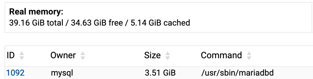

14% is better but does still seem a little high. I think part of the "high" load you are still seeing on the database is due to that model INTEL 5620 CPU you're using which was released way back in 2010, but at 14% you've definitely still got room to grow and for spikes in traffic.

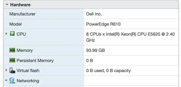

Also, i should state, is the Xeons in a VM environment, if so , what? Some have custom firmware depending on the build. I noticed a huge performance boost using the appropriate vm image for my servers, especially with proxmox, HUGE margins of improvement. Maybe op can share his my.cnf file.

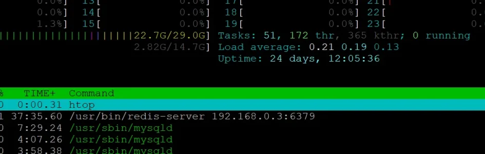

fairly good stable levels.
I've got it virtualised though , so the webserver has its own vm and sql on its own vm. It works well, for me.

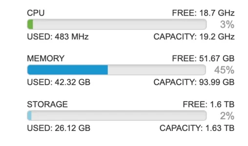

Yes it's running on a VM. VMware EXi with a NFS share on a Synology RS2416RP+
