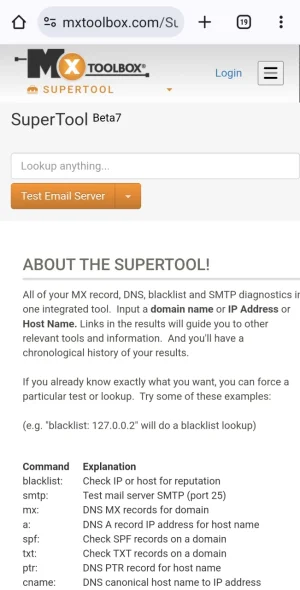

What is the result from MXToolbox super tool -- >> Test Email Server?
Yes, the service works correctly.
