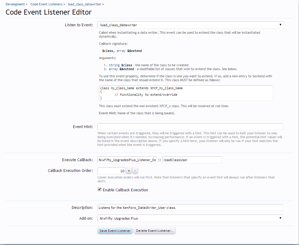

My Listener:
class NixFifty_UpgradesPlus_Listener_DataWriter
    public static function loadClassUser($class, &$extend)
        if ($class == 'XenForo_DataWriter_User')
            $extend[] = 'NixFifty_UpgradesPlus_DataWriter_User';
And the Code Event Listener:
