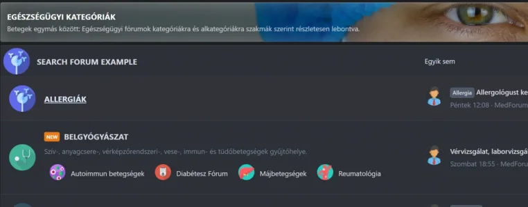

One more thing, for some reason Search forum doesnt seem to be in the same "line" as other forums like this:
It little out of line to the left. Any way to compensate for that, it seems not just the icon but the whole title.
I checked and it is the same even without the extra.less modification, the title was a little to the left even without the new icon.
I will need to see this on your site but try adding this to your extra.less template:
Less:
.node.node--id99.node--depth2.node--search {
    margin-left: 0px !important;
Or adjust the margin to a negative value. Check the mobile view after changing.

I checked the mobile site and it appears that the icon is smaller then the others in mobile view...
Which is independent from the margin.
