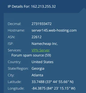

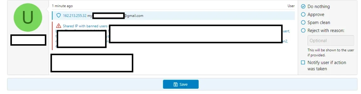

Myself, my mods, banned spammers and everyone is being detected as the same IP address so the whole forum is acting up.
My host is NameCheap which is showing as the user's IP address origin.
This is likely a server configuration issue or some sort of issue with a proxy. I'd probably contact the host in the first instance. The IP address headers XenForo reads from contain their IP address rather than the user's. That either needs to be fixed by them, or they need to pass the real user's IP address in a different header so it can be detected by XenForo.
