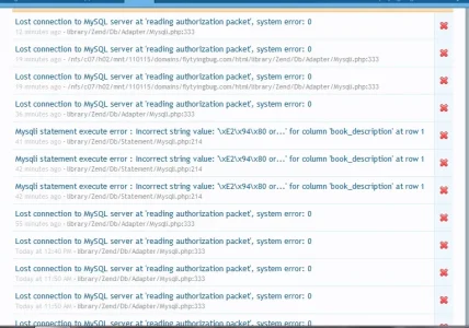

I'll be honest, I don't know what any of those mean, but I'm pretty sure 100% of them shouldn't be there in a working configuration.
One of the tables it complains about is "book_description".
Do you know what add on this might refer to? Have you got an add on installed to do with books?
Do things change if this were to be disabled?
ya, that one has something to do with the Book review addon but happened only when adding a book, not the problem. This has bee happening well before this addon was installed, cheers thanks.
Ok so it's these others:
Lost connection to MySQL at 'reading authorization packet' errors that might need looking at.
If you click on one of these what's the output?
That error is caused by one of these MySQL settings being exceeded:
wait_timeout
max_allowed_packet
Your host or server person needs to increase these settings in MySQL. There is more info here:
http://dev.mysql.com/doc/refman/5.1/en/gone-away.html
Incorrect string value
That is a problem with the collations in your database. Read this thread starting from this post:
http://xenforo.com/community/thread...red-please-try-again-later.14832/#post-194621
I'm not sure what table it's from since the named column (book_description) is not in the default software. It must be a table for an addon. Check the collations.
