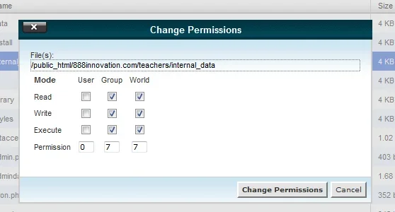

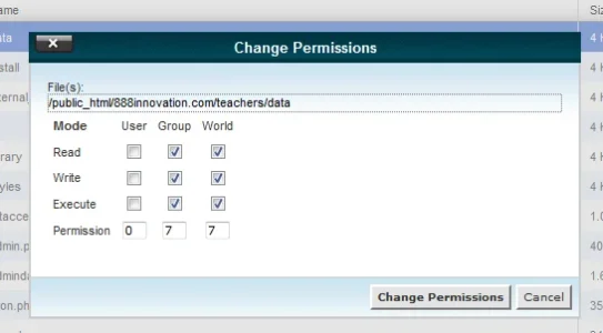

I changed the permissions on the folders below, but I still get this error. Can anyone tell me what I might be doing wrong?
he following errors occurred while verifying that your server can run XenForo:
  • The directory /home/dustinma/public_html/888innovation.com/teachers/data must be writable. Please change the permissions on this directory to be world writable (chmod 0777). If the directory does not exist, please create it.
  • The directory /home/dustinma/public_html/888innovation.com/teachers/internal_data must be writable. Please change the permissions on this directory to be world writable (chmod 0777). If the directory does not exist, please create it.
I don't understand what you mean by all subdirectories. I am creating this installation as a subdirectory. I already have Xenforo on my main URL. I created a folder called "teachers". /home/dustinma/public_html/888innovation.com/teachers/internal_data
Do you mean I need to set teachers to 077? I tried that but then it said there was a server error.
Dustin
The data/ and internal_data/ directories have sub-directories.
The two parent directories and all sub-directories must be 0777.
What do you see for the permissions in your FTP application when you look at those directories?
See attached. I tried the same settings on the subdirectories inside the folders, but still have the same problem

Ok, I changed all of the folders in internal data to 777. Do I even change the htaccess and other files to 777? I changed everything to 777 and now I can get into my control panel. But should htaccess be 777?
If you have shell access then try running these commands to recursively set permissions in those directories:
chmod -R 777 data
chmod -R 777 internal_data
You might also try 755 permissions. Depending on how PHP is installed, 755 may still be writable. I have seen some server configurations throw errors with 777.
Do not change the permissions on any other directories or files except for data and internal_data. As I said, some servers will throw errors if you grant too many permissions. Depending on the server configuration, all other directories should normally be 755 and the files be 644.
Yes, I am getting some server errors now. I don't understand how to run commands. Can you explain how it is done? Do I make all of the files in data and internal data 755? Even htaccess?
Dustin
Yes. data and internal_data, and all files inside of those directories should be fully writable. That means 777 or 755 depending on your server configuration. If not with shell access then any FTP client can do it.
