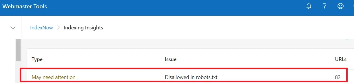

I have been using this add-on for a long time and I've never had any problems with Bing, discussions were always indexed quickly, for the past 3 weeks I have been trying IndexNow integrated into 2.3 and the problems have started...
I didn't understand initially why they weren't indexed, I thought it was a robots.txt problem with Disallow: /posts/
https://xenforo.com/community/threa...content-in-search-engines.199574/post-1695084

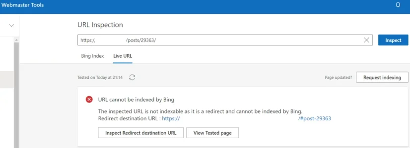

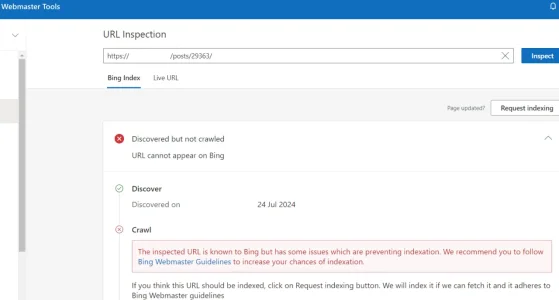

After removing "Disallow: /posts/" from robots.txt I realized that there is also a redirect problem and in the Bing guideline it is written that the links sent must not be redirects.
With Indexnow integrated no discussions were indexed in 3 weeks, reactivating the previous add-on they were indexed in 48 hours.
Note: since most XenForo installations, as also suggested here, use "Disallow: /posts/" in robots.txt it would be recommended to change the link used by IndexNow.

i didn't remove Disallow: /posts/ from my robots.txt file and I have no problem reported in Bing > IndexNow.
But did you check here?
Before I removed the 'Disallow: /posts/' from my robots.txt I had these errors!
Then after deleting it 5xx errors started for redirects
Thank you for your feedback, I don't understand then the cause of all my mistakes... I didn't have these errors with the previous add-on.
