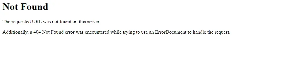

hi , To remove index.php from my site url i ticked option "Use full friendly URLs" and it successfully removed index.php from my forum main url, but now when i click any Node of my forum i got this error below as shown in screenshot, how can we also remove index.php from nodes url successfully.?

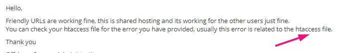

I had discussion with host, and they advised me to edit the .htaccess file for friendly URLs,as shown in screenshot below,But i am not sure what codes in .htaccess i need to edit for friendly URLs.
