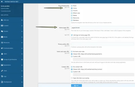

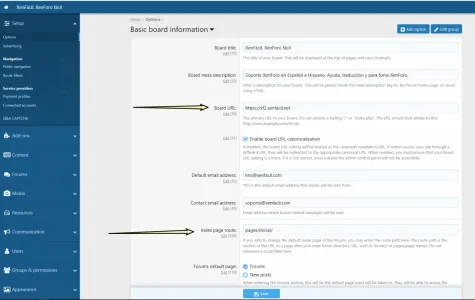

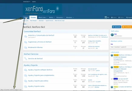

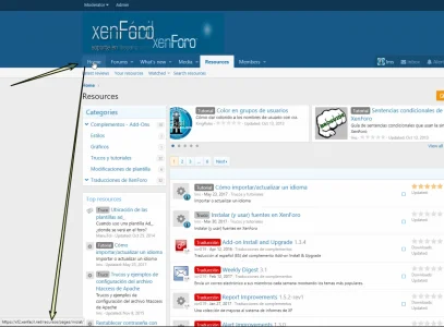

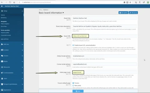

Chris D XenForo developer Staff member Licensed customer Sep 25, 2017 #2 Is the Inicio tab the default "Home" tab? If so what value do you have set as the "Link"? What is your Homepage URL in the "Basic board information" options? Or is this an additional navigation tab you've added? If so, again, what is the "Link"? Upvote 0 Downvote

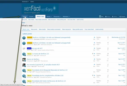

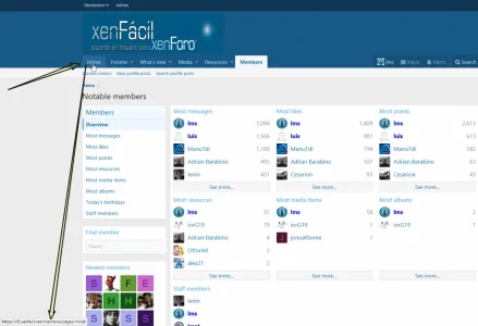

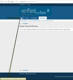

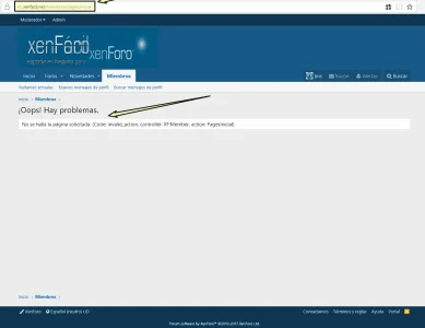

lms Well-known member Licensed customer Sep 26, 2017 #3 Chris D said: Is the Inicio tab the default "Home" tab? Click to expand... Yes. Chris D said: If so what value do you have set as the "Link"? Click to expand... Chris D said: What is your Homepage URL in the "Basic board information" options? Click to expand... Chris D said: Or is this an additional navigation tab you've added? If so, again, what is the "Link"? Click to expand... No. I do not added any additional navigation tab. This also happens when pointing to the logo. Salud2 Upvote 0 Downvote
Chris D XenForo developer Staff member Licensed customer Sep 26, 2017 #4 Your home page URL is wrong. Your home page URL should just be the same as your board URL in this case. Upvote 0 Downvote
lms Well-known member Licensed customer Sep 26, 2017 #5 Are you right. Solved. Thank you very much. Salud2 Upvote 0 Downvote
