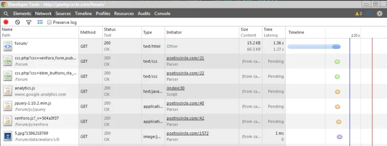

My forum home is loading at ~ 3 seconds, which is too slow, even on an SSD-based VPS.
I notice that xenforo's home page loads much faster.

It's taking 1.3 seconds just to get the initial response from the db queries before it even starts to load the js / images / css etc
I'd suggest you start by taking a look at the configurations of the webserver and database, and try and implement caching where possible.
FYI, I figured out that a low TTL value (set to 0 in some cases) in some of the sidebar blocks--part of the bd widget framework--was causing much of the home page slowness.
