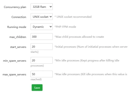

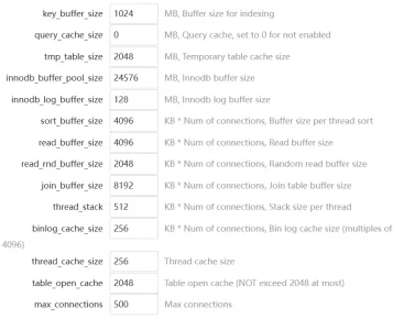

Here is my Mysql config:
In addition, I checked my "innodb" settings based on some search results on this forum, not sure if these are accurate:

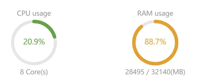

Server load:
Anyway, I've been at this for 7 hours tonight and its 4am. Going to let the import process continue and see where things are. If anyone has any ideas, I would appreciate it!

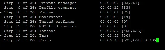

I've solved the issue of the import process seeming to stall at step 14, it turns out my browser was timing out. I switched to Firefox and now its not timing out. That being said, Step 14 of importing threads is taking 35 seconds per thread. I have 455,000 threads. Need to find a way to speed this up.
