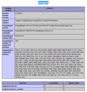

If I go to the PHP test info page, it says Imagick is loaded so I'm at a loss as to why it's not working. Any help would be appreciated!
Shared hosting, VPS/dedi?
OS installed if VPS/dedi?
Version of ImageMagick installed (and what does your php info page reflect)?
OK... one more quick question... PHP 5.5.8, 5.5.9, 5.5.11 or what?

PHP 5.5.10-pl0-gentoo

It's just strange. I've been testing further and animated GIFs convert just fine, while a JPEG spits that error out :/
Okay the error occurs in the function 'createFromFileDirect' in XenForo_Image_ImageMagick_Pecl with the following error message:
no decode delegate for this image format `/tmp/phpROmf9r' @ error/constitute.c/ReadImage/501
