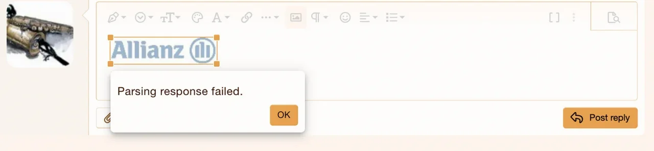

One member is getting We ran into some problems error when uploading jpeg images (not bigger than the allowed size or dimensions)
On a test with a small (4kb) image he got this message (which as far as I can tell is not xenforo?)
Can anyone please help? Thanks
Other thing to try would be attaching it using the "attach files" button, as it may give a different error.
Saying that, a quick glance at the code makes me think this could be related to a browser extension manipulating and breaking the output from the server.
Same issue now one of our members is complaining about the same error. I do not have any way to investigate further but I asked him a couple of questions and will post here once he replied.

Just FYI, I was having the same issue trying to upload images on my forum. Seeing rexxxy's comment about nord VPN prompted me to try something. In my Safari settings, I unchecked "Hide my IP" and viola, I could upload images again. Just dropping this comment in case anyone else with Safari has this issue, it's something to try.
