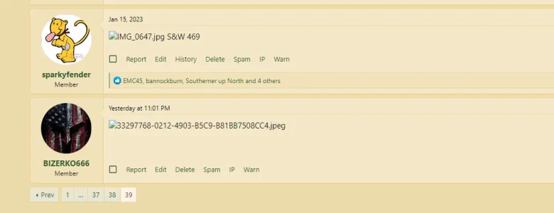

To better explain, I just looked at a thread where people have been sharing relevant photos since 2014. Other than the photobucket errors on early posts, they all show inline and clean, except these last two, which are appearing as follows:
Now, both of those were probably uploaded between the test migration that worked, and the recent "lets just copy newer files over the old ones from the attachment directory."

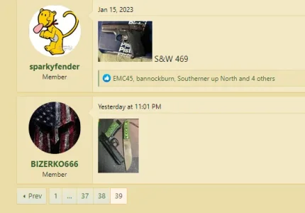

I found the same posts and this is what I see:
I can't click on them to get a larger size since I'm not a member, but at least this is what shows for a guest.
