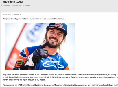

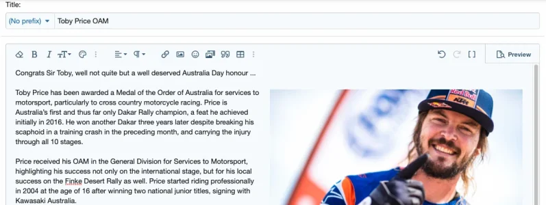

When editing a post, in an Article Thread if that matters, and having added text and inserted upload image(s), when clicking an image and changing it's alignment to right so that text wraps to the left of it, it displays correctly in the editor. But in both Preview or posted/saved displays, the image alignment and text wrapping doesn't work.
Screen Shot 2021-02-17 at 22.34.47.webpScreen Shot 2021-02-17 at 22.35.12.webp
Default Style, with no customisations, used to ensure it wasn't an issue with child styling.
