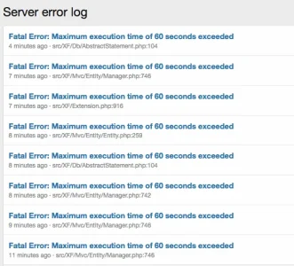

Today I noticed my site slowing down and I started getting memory exhausted errors. So I did a server reboot and almost immediately new errors started. This time they were ErrorException: Fatal Error: Maximum execution time of 60 seconds exceeded. I'm attaching a screen shot. Disabling XFMG solves the server errors. Any ideas on what's happening or what I should be looking for?

Waiting to hear back I tried to increase pho time and memory. No joy I still can’t turn on MG. The memory error stack is
  • ErrorException: Fatal Error: Allowed memory size of 2147483648 bytes exhausted (tried to allocate 1416377536 bytes)
  • src/XF/Db/Mysqli/Statement.php:86

Is this happening on non-XFMG pages? Or just when you view a certain part of the gallery?
Those memory errors are... interesting, as it seems to suggest it's a 2GB memory limit and PHP is trying to allocate something like 1.4GB in one go. There have been rare occasions where we've seen memory limits errors like this but it's been a very long time and I think it had something to do with a specific MySQL library setup.
If it's on one of the main XFMG pages, there could be performance elements that relate to the size of the gallery. There are some options that can improve this (notably, reducing the number of days worth of media that is shown by default). These usually tend to just manifest as time issues, no memory issues though. Memory issues would generally relate to pulling a lot of data and I think we try not to include more than is necessary.
We might need you to submit a ticket with admin login details so we can at least see the issue in place (so we can toggle XFMG on and off).
