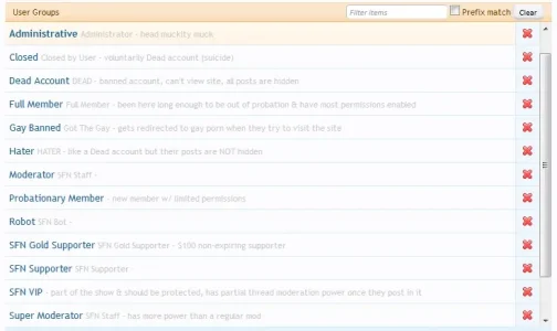

1/2 because I wanted it & 1/2 because I wanted to learn how to do it, I hacked the code to add a usergroup description field. so far it's only seen in the AdminCP on the add/edit usergroup page & the usergroup list page. if you're wondering why, it's so I could decide how to set the permissions.

- edited "user_group_edit" admin template to add "description" field
- edited "user_group_list" admin template to add "description" to usergroup snippet

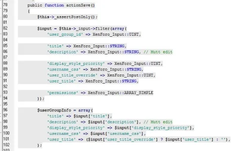

- edited ControllerAdmin\UserGroup.php in 2 spots to read & save description field

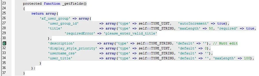

- edited DataWriter\UserGroup.php in 1 spot to list description as a valid field

my question is, would it have been possible to do this as an addon instead of a code hack? if so, could someone point me in the right direction? the code hacks are attached as screenshots. for obvious reasons I'd rather not hack code & edit templates but I have to learn to crawl before I can walk so getting the damn thing to work was step 1. it took me long enough to figure out the valid field thing.

Neither of those templates have any hooks so you wouldn't have been able to add that field without replacing those templates or hacking away at the HTML using one of the template code events. Short answer... those template changes are not easily done with an addon.
The two file edits can be replaced with code event listeners for "load_class_controller" and "load_class_datawriter". You would create extended classes for both of those files you edited.
The database field would need to be added in the install code of the addon.
