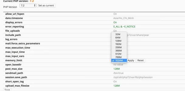

Log is: Allowed memory size of 1073741824 bytes exhausted (tried to allocate 1751085952 bytes)Check the server error log for more details on the 500 error.

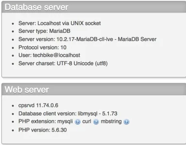

Which MySQL version you are using ?My site workring with php 5.6.But when i update from php 5.6 to 7.2 then site not working with error code 500.

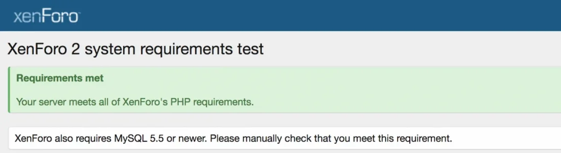

I has check xenforo_requirements.php
Your server meets all of XenForo's PHP requirements.

not possible for your host to increase the limit for timebeing ? though I feel 1024M limit is good enough unless some serious problem or memory leak is there !Log is: Allowed memory size of 1073741824 bytes exhausted (tried to allocate 1751085952 bytes)

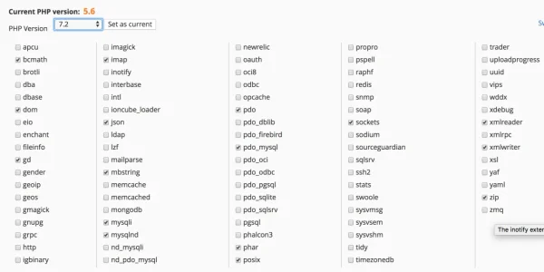

This works! But is this the best way? What does this change mean to the rest of the website and why is this necessary?Try disabling PHP modulemysqli
and enablend_mysqli
@Brogan is this something you can look at?nd_mysqli: this extension is referred to as MySQL improved. It was developed to take advantage of the new features available in MySQL since version 4.1.3.
That's as far as I know. I use this module with no problems.
