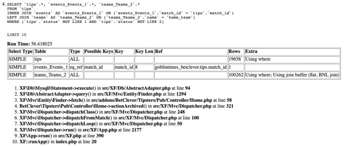

Go the page where you get slow response then click on value for "Time" in the footer and finally share result of
  1. In the page where you're getting slow response
  2. Click on the value of "Time" stat in the footer
  3. Find the query which starts with
    SELECT `tips`.*,
    and share the entire block which should look something like this 203945

Table tips doesn't habe a usable index for the WHERE condition on field status
Table teams doesn't habe a usable index for the LEFT JOIN on field name
Also, it seems kinda wasteful to me to have that join at all, you are always joining the exact same record(s) all the time?
I think what you really wanted to have is ON (`teams_Teams_2`.`name` = `events_Events_1`.`home_team`)
