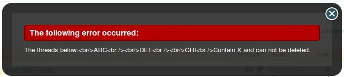

The reproduction steps are pretty simple.
Create a phrase with a variable. Call it threads_x_error
The threads below:{titles}Contain X and can not be deleted.
Then populate the variable and send it to the phrase:
$titles = array('ABC','DEF','GHI');
$sendTitles = '';
foreach($titles as $title)
      $sendTitles .= '<br/>' . $title . '<br />';
return $this->responseError(new XenForo_Phrase('threads_x_error',array('titles' => $sendTitles)));
And the result will be:

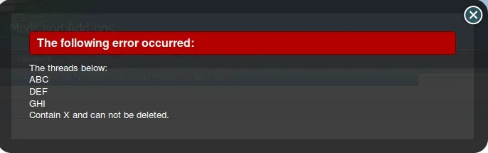

The expected result is:

return $this->responseError(new XenForo_Phrase('threads_x_error',array('titles' => $sendTitles), false));
Indeed, the issue here is that you're trying to pass HTML in a parameter. Parameters are HTML escaped by default. Without this, you'd basically have XSSes everywhere. The "false" mentioned by @Arty disables the escaping, which means you'd be responsible for it (escaping the parts other than the HTML you're trying to inject).

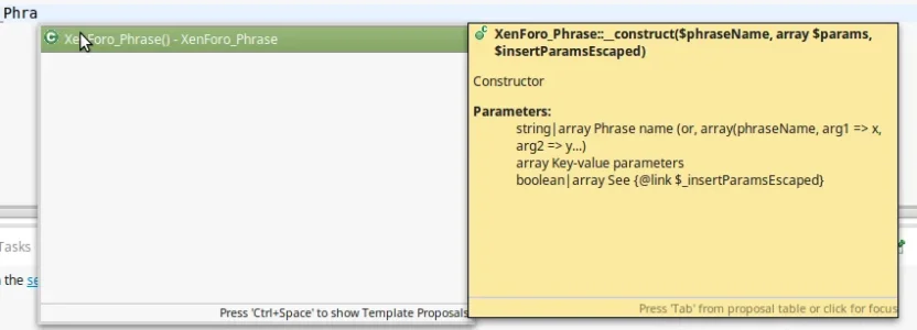

Thanks @Arty and @Mike, I had completely forgotten about the false parameter because in 99.99% of the cases it's not needed.
And of course I was also ignoring the fact that Eclipse was giving me the answer all along.:rolleyes:
