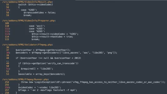

For disk space saving, I would like to transcode all videos to H.265.
Forget about compatibility with client devices :)
Which file specifically I need to modify on the XFMG source?
Thanks.

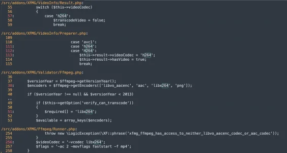

Maybe this one edit is already enough?
I suspect so but I haven’t tested it.
The other changes may be required if you want to detect if a video is already encoded in h265 and therefore skip transcoding but tbh I would transcode all videos which there is an option for. The transcoding process would probably still bring the size of the h265 videos and others down regardless of whether we deem them compatible.
