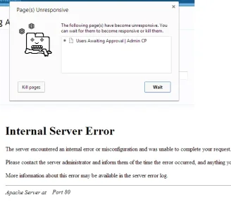

I keep getting a script error (http://www.....com/js/jquery/jquery-1.5.2.min.js:16) and when I click "process users" it gives me an error message.
Oh you know what? You said you have 3500 users to process? That's a very large form. The security error can be the result of such a long form exceeding limits set in a hardened PHP installation. Are you running suhosin? Ask your host or server person to disable suhosin or to relax the various "max_vars" settings within suhosin (to something higher than 3500).

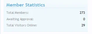

Can mass deleting users awaiting confirmation be done with a SQL query ?
Hostgator are retarded! I'm putting those settings into php.ini nowJust talked to Hostgator and Suhoisin is not installed by default but he doesn't know why I could not delete 3500 users. He's issued a ticket but we're not even sure what to look for at this point. Any other ideas why I can't delete them?
[23-Jan-2013 16:28:42 America/Chicago] PHP Warning: Unknown: Input variables exceeded 1000. To increase the limit change max_input_vars in php.ini. in Unknown on line 0
max_execution_time = 300
max_input_time = 300
memory_limit = 256M
max_input_vars = 20000

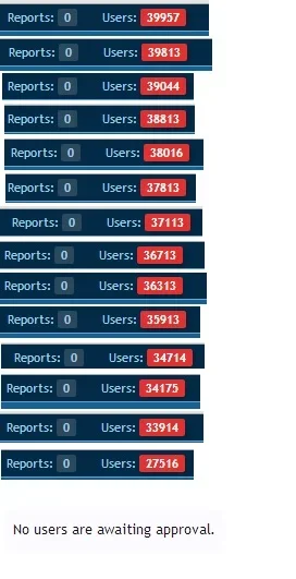

I'm getting rid of 100 at a time.
this - community/admin.php?users/moderated
lists 100 at a time (it takes 20 seconds to delete 100)
Can I bump it up to 1000 at a time ?
So when I click View attachment 60068 ... it does 1000 / time.
* Shows a list of moderated users and allows them to be managed.
* @return XenForo_ControllerResponse_Abstract
public function actionModerated()
$users = $this->_getUserModel()->getUsers(array(
'user_state' => 'moderated'
), array('limit' => 100));
#NoEnv ; Recommended for performance and compatibility with future AutoHotkey releases.
; #Warn ; Enable warnings to assist with detecting common errors.
Sleep 10000 ; Wait 10 seconds
Loop 400
Loop 28
Send {PgDn} ; goes to the bottom of the page
Click 597, 894 ; clicks Process Users
Sleep 30000 ; Wait 30 seconds.
array('limit' => 400)
SendMode Input ; Recommended for new scripts due to its superior speed and reliability.
Sleep 10000 ; wait 10 seconds
Loop 80
Loop 128
Send {PgDn} ; get to bottom of page.
Click 597, 894 ; click process users.
Sleep 120000 ; Wait 120 seconds.
