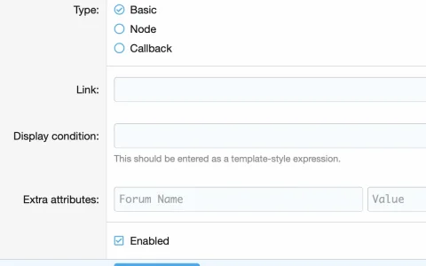

I have done that here:
Is that what you mean? What I did was make it so that the top level nav did not have a link- just leave the link field empty in the navigation manager.
Instead when you click it shows the children dropdown.
In my case there is no actual "about" page, but with the main Forum tab I just added a link to the forums list as the first child. In your case if there is a movies page or forum you need to make it a child. (As I have done on the forum tab)
