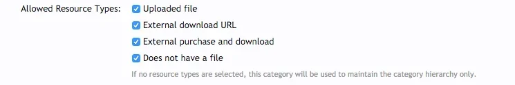

For that category, if you uncheck all of these:
Then the category will behave like this one: Add-ons | XenForo Community

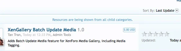

You can't add resources to this category, but instead of it saying there are no resources to display, it instead displays all resources from the child categories. It displays the following heading above the list of resources: "Resources are being shown from all child categories".
Exactly my point.
It is confusing because people don't know they must then click on one of its subcategories.
And the text you mention is tiny and faint.
