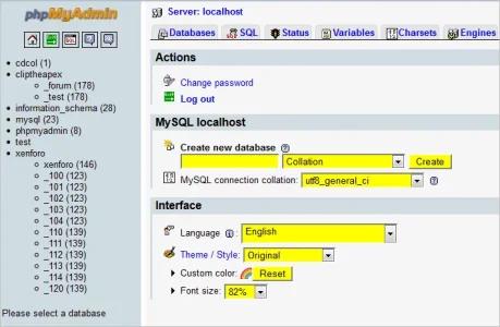

When I get to this step:
There is no option for 'New Database'
You need to log in first using root/root.
Then the option will be available.

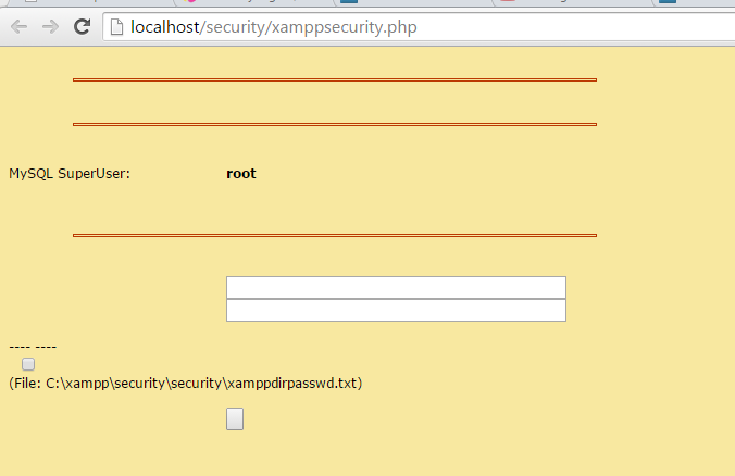

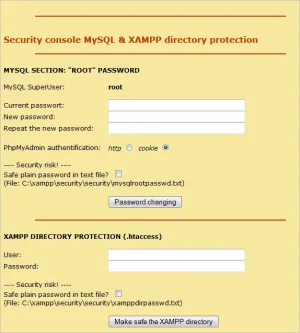

Looks like there's something wrong with your installation.
It should look like this:
You may want to post on the xampp forum for help.
Okay, I finally got the security part to display properly.
