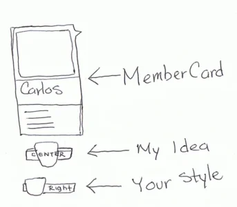

Finally, how can I position the rank images below the member card - not inside it, but outside of it - ya know where the empty post bit is?
Like this:
Ignore the bottom part where "your sytle" is noted. This was a rough sketch of what I wanted.

Are you talking about where the extraUserInfo (the number of posts, date joined, etc) data is posted? Or are you talking about totally outside the postbit?
From what your drawing looks like you are referring to totally outside the postbit itself - which may require an add-on.
Yes, exactly. Awe man. It requires an add-on. :(

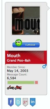

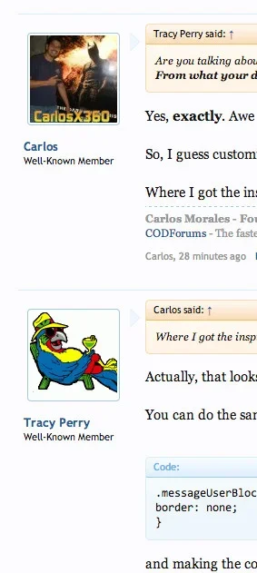

Actually, that looks like they ARE displayed in the postbit for vB... but he doesn't have a border around the postbit so it appears that they are not.
You can do the same thing by removing the border around your messageUserBlock.
.messageUserBlock {
border: none;
and making the color for the avatar holder and extrauserinfo the same as the normal background. It just takes a little editing the EXTRA.css and scrounging around for the right areas. Chrome Developer was used to modify the page here for the below example.

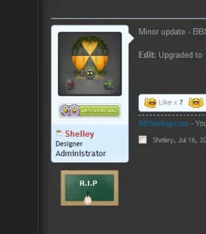

Yes! JUST like that! @Sheldon!
*Points at bottom*
The following seems to work for me.
In your Message_user_Info template add the following above the last closing div in the template.
Before you do these changes carlos you'll have to apply the correct $user,ID and create your own classes for other usergroups, just repeat the code and adjust the css and template change code to reflect your ranks. Probably be best waiting for someone else to jump in as I'm sure there is a better way of doing this, but it seems to work for me.
