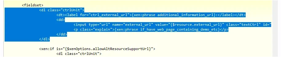

I know it’s located somewhere in the Resource_add template, but I’m not sure what block of code I should comment out.

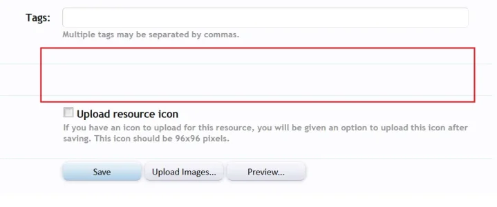

Thank you. That worked perfectly! Now there is an ugly gap between the Tag's field and the Upload Resource Icon option. Is there a way to get rid of this gap?
On the basis that you don't have the other field there, you'd want to remove the whole <fieldset>...</fieldset> that was wrapping the additional info block. (You see see the tag open immediately above the highlighted code in the screenshot.)
