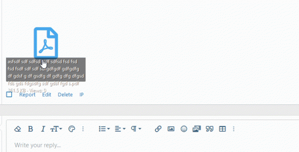

See current version. The damn black bar should collapse down and not inside the icon. If the name is long, it just covers the whole attachment icon.

Thanks, this one is the closest so far, as it finally displays the names fully. But...

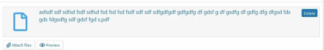

Well, the black background thingy covers the whole icon now. And the filename can't be read well, too. Then if you edit the post, it still goes back to the problem while one can't see what was attached.
Compare it to XF 2.1
In 2.1 one can easily read filename and file ending in both post and post editing.

Exactly, it isn't, hence why the screenshot. In the screenshot you see that all the changes you made, they are not there when you edit a post.
