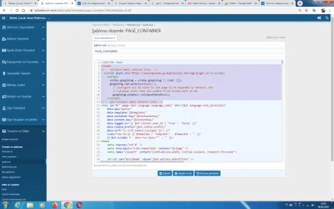

How to collapse empty blank spaces when no AdSense ad is available
djbaxter
I don't know how to create add-ons in Xenforo.
Plus see my update: this script, although recommended by Google, does not work or has stopped working.
Kirby
collapseEmptyDivs() is for ads (including AdSense ads) delivered through Google Ad Manager (previously called Doubleclick for Pusblishers or DFP in short), it will not work for direct Google AdSense ads neither manual nor auto-ads.
It does work just fine for DFP ads, though I am not sure if it is a good idea to use it is it most likely would increase CLS
