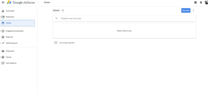

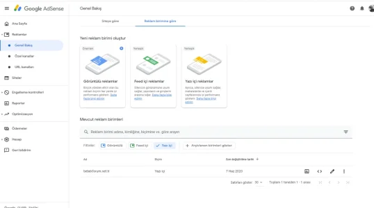

My problem is I shot the ad from the home page. I got it on the message pages. Google divides the header. I'm looking for a solid plug-in for that. Only you can do this
I have been using adsense for years. I haven't learned adsense since 1995. Maybe I'll learn if I use English because I use Turkish.
