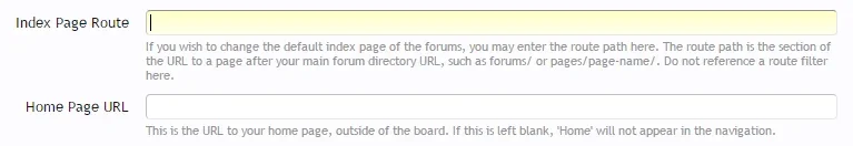

I'm not quite clear what is wanted apart from you want http://www.thehinduforum.com/forums/ to be the page you go to when you visit http://www.thehinduforum.com/
To do this, in Basic Board Information in the ACP, simply remove what is shown in the Index Page Route box:
I don't know what you want to do with XenPorta? Maybe uninstall it if you don't want it?
Regarding blogs, I'm not sure what you are thinking of using for this? If it's something external to XenForo then you can add the URL you want into Home Page URL. Then when anyone clicks on the Home button, they will visit the blog page.
thanks bro
great it worked...but now when i click on home page it gives url as www.thehinduforum.com/portal/ how do i change it to http://www.thehinduforum.com/home/ ?
