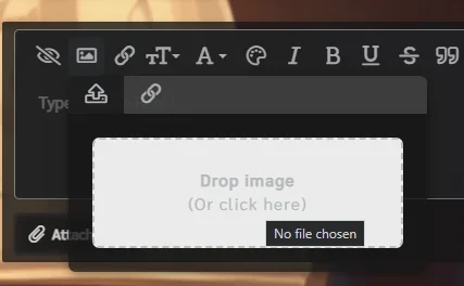

Changing it in ACP didn't work, and targeting the fr-popup element didn't work either. I'm stumped on what to do and how to change this hover color. Any help is appreciated!

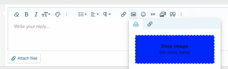

I'm not sure what you are calling the "hover color"... but if that is the white box, then this worked in my browser inspector
.fr-popup .fr-image-upload-layer {
    background: blue;
    background: blue;

Okay! I'll give it a try
Edit: It worked! Thank you so much @TPerry To clarify, it was the background color that popped up when I hovered my mouse over it, so I put the same code but just with :hover and it worked :)
.fr-popup .fr-image-upload-layer:hover {
    background: @xf-paletteColor2;
