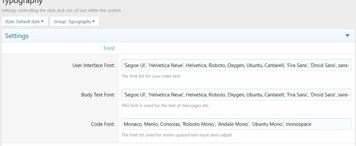

I've searched for answers to this but didn't understand some of them. I'd like to change the default font to the one below. Not sure what it is. I know you can change it in typology but I am a bit nervous about change the string of type as I don't understand what each element does.
Ok so this is what I have in Typography. I assume I change font titles to what I want but a bit scared of messing it up and not being able to revert. So do I just keep the same format and change the font titles? There seem to be a few fonts in each line which is confusing.
Thank you for reminding me - I was taking a lot in at that time and didn't quite understand where to put that. So I don't change anything in the Typology boxes above then? Just add the code to extra less? I can't see an extra less code box on the Typology page. Sorry I am being so dim!

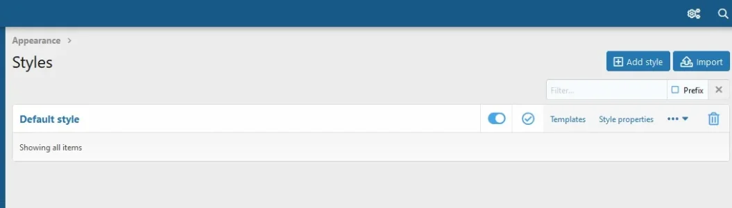

Posted at the same time. Ok I am with you. So what would I put in extra less to change the node fonts? Would it be .p-node-value ?
Used Typology to change the node headings :-) Thank you very much. I was so stuck on fonts.
